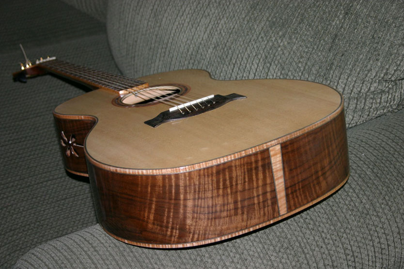

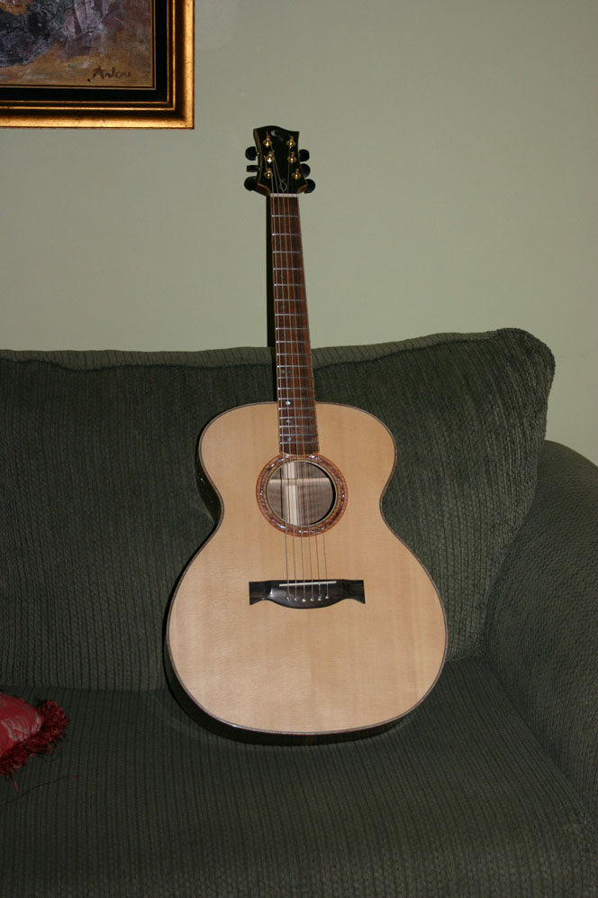

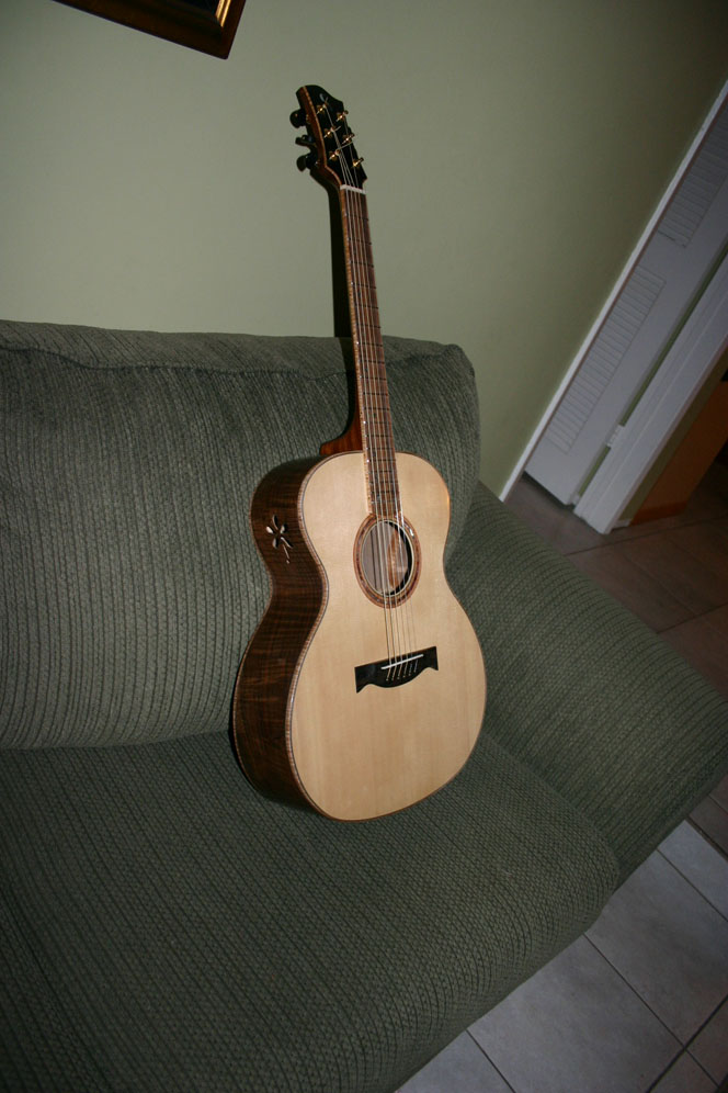

Well, I finished the guitar for my wife and was about ready to give it to her tomorrow when she returns from our church's women's retreat! It would be a nice welcome home present! ******BUT******* something else arose.....there is a buzz when I strum the A string and it only happens with the open A string....no buzz when I fret at any position...strum softly or hard...same result
Any ideas?
TIA

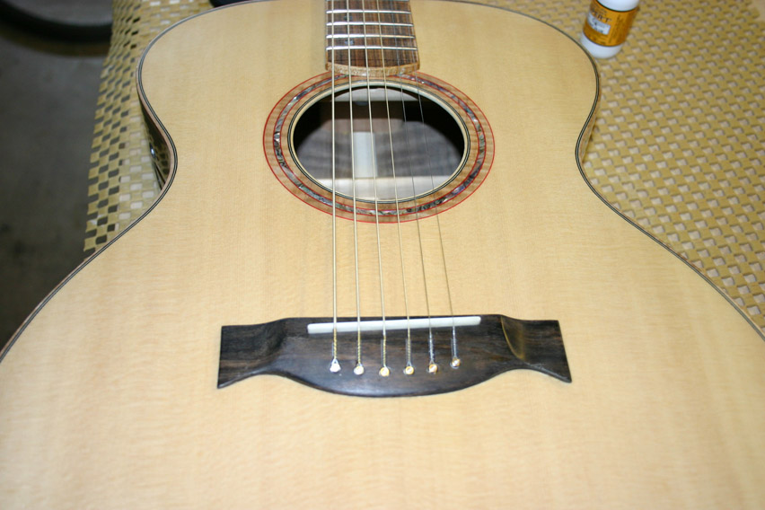

Rich, the headstock and bridge are my original designs... My first 4 guitars I used Martin kinda look a like bridges but the last 2 have been fitted with this last design wich features a pinless bridge design like J. Elliot invented!

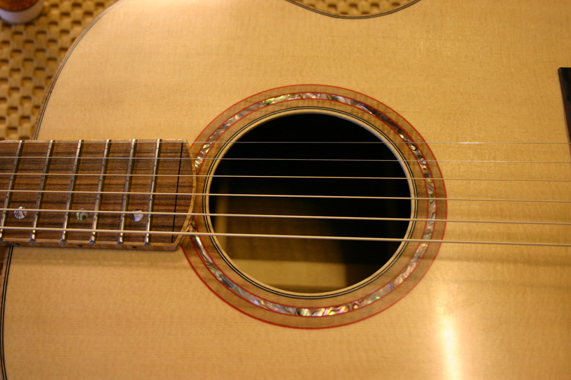

Here's the bridge and rosette
I'm still waiting for the fret wire from LMI, thus the lack of the last fret!
For you guys that may be considering....DON'T USE STAINLESS FRET WIRE!!!!!!!!!!!! it was a pain to cut and it dulled my tools!
